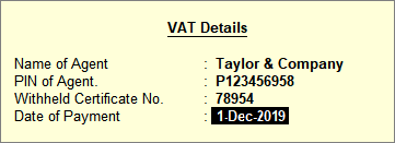

7. Set the option Provide VAT Details to Yes to enter VAT withheld details.
8. Enter Name of Agent , PIN of Agent. , Withheld Certificate No. , and Date of Payment details.
9. Press Enter . The journal voucher appears as shown below:
