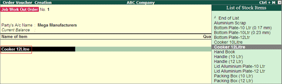

5. Order No : In this field enter the Job Work Out Order Number. For example, Job - 001.
6. Name of Item : In this field select the stock Item i.e. Finished Goods to be manufactured by the Job Worker. E.g. Cooker 12 Litre . Press Enter to view Stock Item Allocations screen.

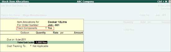

● In Stock Item Allocation screen
o Item Allocation for : By default the stock Item selected in the Job Work Out Order will be displayed, indicating that the Β item allocation is for the selected item.
o For Order Number : By default the Job order specified in the Job Work Out Order will be displayed indicating that the item allocation is for the job order specified.
o Track Components : By default this field will be set to Yes. If the Principal Manufacturer wants to track the raw materials used in the manufacture of finished goods retain the Setting as Yes.
Note: In case the Manufacturer does not want to track the Raw materials then set the Β option Track Components to No . When this option is set to No , Tally.ERP 9 will not display the Component Allocation Screen.
● Due On: In this specify the Date on which the delivery of Finished Goods is due. In this case ABC Company has accepted the manufacturing Duration of 30 Days (from the day of delivery of raw materials). Hence the 200 Nos of Cooker 8 Litre will be due on 6-1-2011
Note: If the Principal Manufacturer has agreed for the delivery of finished goods in Installments the user can define multiple Due on date with Quantity of delivery .
Example: 500 Nos on 20-12-2010 and 500 Nos on 6-1-2011
● Godown : In this field select the Godown where the finished goods will be stored on Receipt of the same from the job Worker. E.g. Finished Goods Location
● Quantity : Specify the Quantity of finished goods to be received from the Job Worker.

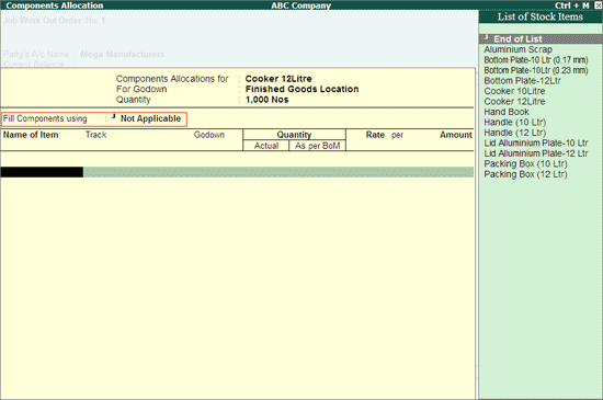

● Press enter from Quantity field to view Components Allocation screen
● In Components Allocation Screen,
Note:
1. Component Allocation screen will be displayed only when the option Track Components is set to Yes in Stock Item Allocation screen.
2. The Finished goods for which Job Work order is raised does not have the Bill of Material (BOM) then in Component Allocation screen, Tally.ERP 9 will skip Fill Component using field and cursor will be displayed in Name of Item field indicating that the Raw Materials required for the manufacture of Finished goods has to be selected from the List of Stock Items .

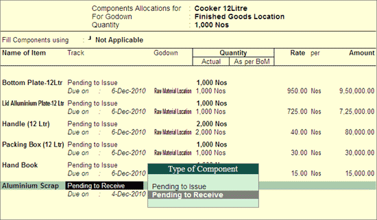

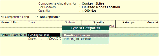

o Name of Item : Select the Raw materials required to manufacture the finished Goods. For example, Bottom Plate-12Ltr.
o Track : In this field select Pending to Issue from the Type of Component list as the Raw materials are pending for issue to the Job Worker.
Note: Based on the Job Work Order Tally.ERP will highlight the appropriate Type of Component .
* For Job Work Out Order - Pending to Issue will be highlighted
o Due on : In this field specify the date on which the Raw materials will be delivered to the Job Worker Location. By default the Voucher Date will be displayed in this field. if the Delivery Date is different than the voucher date specify the correct Due on date. Here, ABC Company is delivering the Raw materials on 6-12-2010 .
Note: If the Job Worker has agreed for the delivery of raw materials in Installments then user can define multiple Due on date with Quantity of delivery . For example, 100 Nos on 6-12-2010 and 900 Nos on 7-12-2010.
o Godown : In this field select the godown from where the Raw materials will be delivered to the Job Worker.
o Quantity (Actual) : In this section specify the Quantity of Raw material to be issued.
Note: Cursor will not move to As per BOM field when the BOM is not selected in Fill Component using field.
o Rate : In this field specify the Rate of Raw material consumed for the manufacture of finished goods.

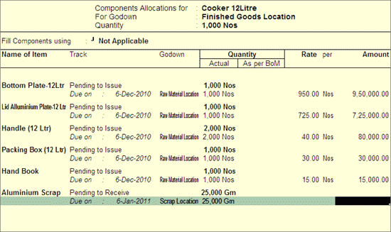

o Similarly, select all the Raw materials to be issued towards the Job work Out Order.
o In the process of Manufacture of Cooker 12Litre , Aluminium Scrap is produced. Under Name of Item select Aluminium Scrap and in Track field select Pending to Receive as the scrap has to be received form the Job Worker along with the Finished goods.
Note: While recording the Job Work Out Order users can also track the Scrap, By-Products or Co-products produced during the manufacture of Finished Goods .
o In Due On field specify the Date on which the scrap will be received, Here, principal manufacturer is receiving the scrap along with the Finished Goods on 6-1-2011 .
o In Godown field select the Godown where the scrap will be stored. For example, Scrap Location.
o In Quantity (Actual) field specify the Quantity of scrap to be received. For example, 25,000 Gm.
The completed Components Allocation screen is displayed as shown:

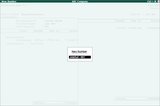

o Cost Tracking To : In this field select New Number and specify the Cost Tracking Number.
Note: ABC Company wants to track the total cost incurred for the manufacture of 12 liter Cooker for the Job -001 delegated to Mega Manufacturer.
The completed Stock Item Allocation screen is displayed as shown:
