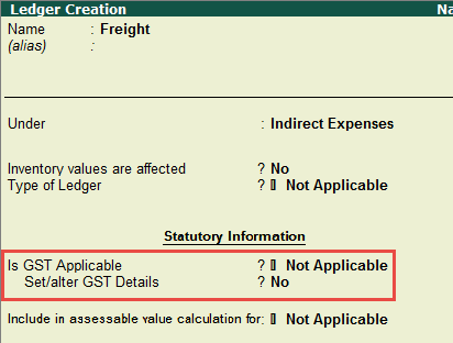

To record transaction for expenses
1. Create separate ledgers for expense and commission.
o In the pure agent expense ledger, set Is GST Applicable? to Not applicable .
2. Record the sales invoice in the accounting invoice mode for the expense, without charging tax.
3. Accept the transaction.

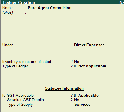

To record transaction for commission
1. In the commission ledger (income), set Is GST Applicable? to Applicable and select Services as the Type of Supply .
2. Record the sales invoice in the accounting invoice mode.
3. Select the commission ledger and tax ledgers.
4. Accept the transaction.

Only commission is charged by the pure agent
1. Create a ledger for the commission charged and enable GST with Services as the Type of Supply .
3. Select the commission ledger and enter the amount.
4. Select tax ledgers.
5. Accept the transaction.

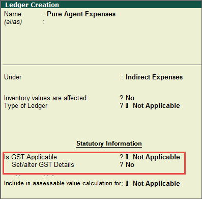

To record purchase of expenses with two separate ledgers
1. In the pure agent expense ledger, set Is GST Applicable? to Not Applicable .
2. Record the purchase invoice in the accounting invoice mode for the expense, without charging tax.

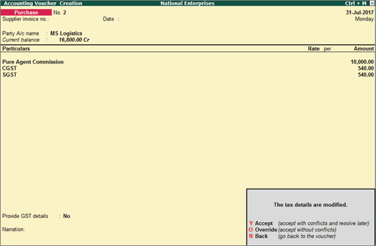

To record purchase using a single ledger
2. In the purchase invoice, click F12: Configure and enable the option Allow modification of tax details for GST?
3. Select the commission ledger and enter the total value of commission and expense, and press Enter . The GST Details screen appears.
o Click F12: Configure and enable the option Allow override assessable value?
4. In the GST Details screen, enter taxable commission in the field Taxable Value .
5. Select the tax ledgers.
6. Press O to accept without conflict.
