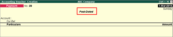

2. In the Voucher Creation screen, click T : Post-Dated . The voucher will be marked with the words Post-Dated as shown below:
3. Click F2: Date and provide the date of the cheque.

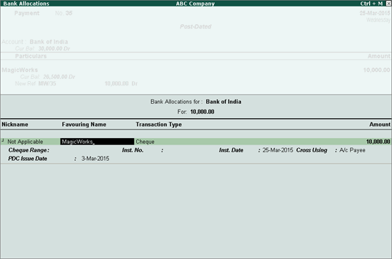

7. Press Enter . The Bank Allocations screen appears as shown below:
8. Fill in the required details. A new field, PDC Issue Date , will be available in the screen. This field is available for post-dated transactions only. Fill in the date on which the post-dated cheque was issued to the party. By default, the system date is captured.

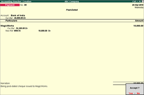

9. Press Enter to save the bank details. The Voucher Creation screen appears. Provide Narration if required.
10. Press Y or Enter to accept.
