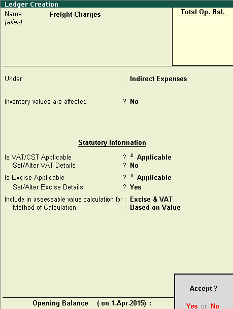

The completed Ledger Creation screen appears as shown below:
