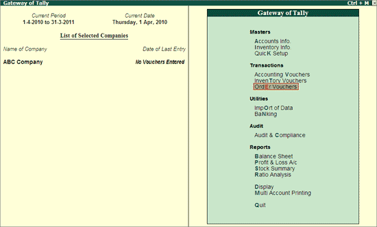

For a company in which Job Order Processing is enabled the Gateway of Tally Menu appears as shown:
