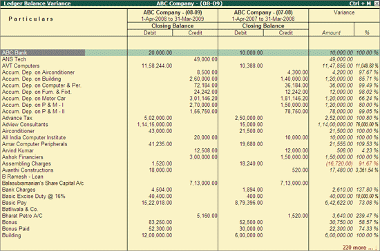

1. Go to Gateway of Tally > Audit & Compliance > Audit & Analysis > Verification of Balances .
2. Click V : Balance Variance or press Alt+V .
The above displays the Ledger wise Closing Balance values for Previous Year and Audit Year (Current Year) along with the Variance in Amount and Percentage . The above report also displays the Verification Status for the Ledgers which are already checked and verified by the auditor.

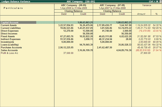

● F5: Grouped : Click F5 : Grouped or press on F5 to view the Group wise Balance Variance report.

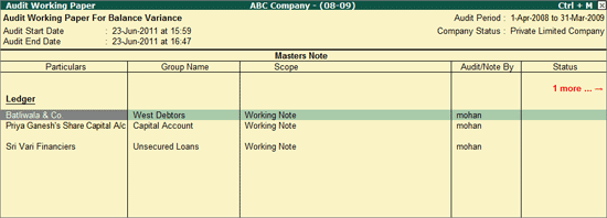

● W : Working Note : Click W : Working Note or press Alt+W to specify the working note details at Company or Group or Ledger level. The details provided in working note will be captured in Audit Working Paper along Β with the details of User Name , Working Note Date and Time , Status , Note and so on.
For more details on Working Paper refer the topic Audit Working Paper .

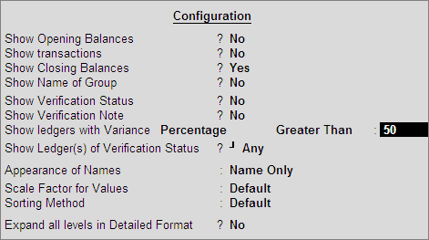

Click F12 : Configure or press F12 to change the default display for the above report.
For more details on the F12 : Configuration options, see Trial Balance report.
Additional options in the above report are explained below:
● Show Verification Note : Set this option to Yes to display the verification note entered by the Auditor.
● Show Ledgers with Variance : This is a filter option to display the Ledgers with Variance Greater than, Less than or Equal to the entered value. The details can be filtered based on the Percentage or Amount.
● Sorting Method : Β Select the required Sorting Method from Default, Alphabetical (Decreasing), Alphabetical (Increasing), Variance % wise (Decreasing), Variance %wise (Increasing) Variance Amount-wise (Decreasing) and Variance Amount wise (Increasing) for the Ledgers.
