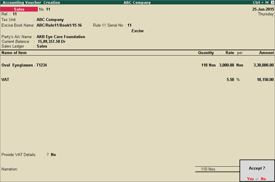

1. Go to Gateway of Tally > Accounting Vouchers > F8: Sales . On enabling excise, the sales invoice will be marked as Excise . If it is not marked as Excise press Ctrl+E to use it as excise sales invoice.
Note: To record a commercial invoice, press Ctrl+E to use it as a non-excise invoice.
2. Enter the reference number in Ref. field.
3. Select the required Tax Unit .
4. Select/retain the Excise Book Name .
5. The Excise Book Name linked to tax unit appears automatically. If multiple excise books are linked to tax unit, the required excise book can be selected from the List of Excise Books .
6. Select the Party’s A/c Name from the List of Ledger Accounts .
7. Select the Sales Ledger grouped under Sales Accounts . In the sales ledger, ensure the options Is VAT/CST Applicable and Is Excise Applicable are set to Applicable .
8. Select the required Nature of Transaction i n the VAT Classification Details screen . For example, Sales Taxable .
9. Link the purchase bills. The purchase bills can either be:
o Automatically linked to excise sales invoice
o Manually linked to excise sales invoice
10. Select the VAT ledger. Click here for detailed procedure on creating VAT ledger.
11. Set Provide VAT Details option to Yes/No as per requirement.
12. Accept the sales invoice.

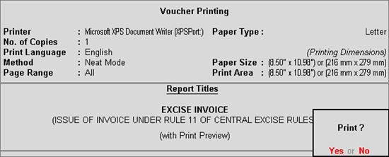

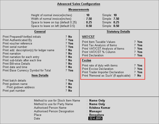

The sales invoice can be printed in Rule 11 invoice format.
To print Rule 11 invoice
1. Press P : Print button. To generate a preview, click I : With Preview button.

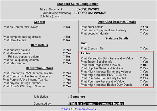

2. Click F12: Configure and enable the options as shown below:
3. Press F12 and set the options as shown below:
4. Accept the Invoice Print Configuration screen. The Voucher Printing screen appears as shown below:
5. Press Enter to print invoice in Rule 11 invoice format.

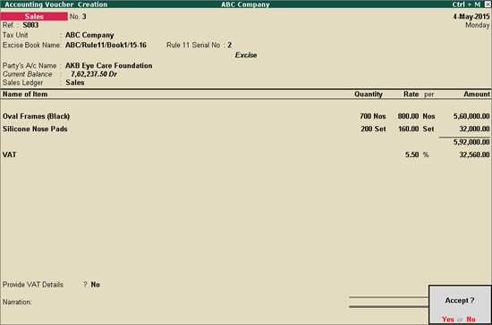

9. Click F12: Configure and set the options as given below to select the purchase bills multiple nature of purchases.
● Set the option Use defaults for excise bill allocations to No to select the purchase bills
● Set the option Allow different nature of purchase for excise bills to Yes to select bills of different stages of purchase.

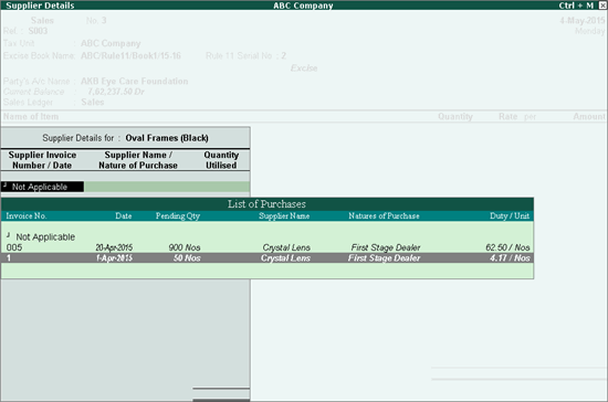

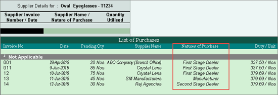

10. Select the stock item. The Supplier Details screen appears.
11. Click F12: Configure of Supplier Details screen and set the option Show Nature of Purchase to Yes .
The Supplier Details screen appears with Nature of Purchase column as shown below:

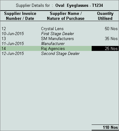

12. Select the required purchase bills.

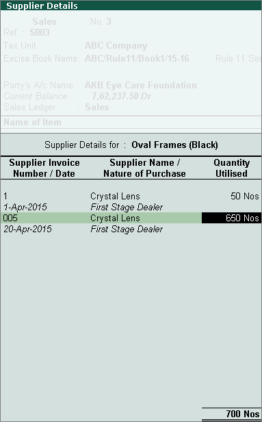

The Supplier Details screen with different purchase bills appears as shown below:
13. Accept the Supplier Details screen.
