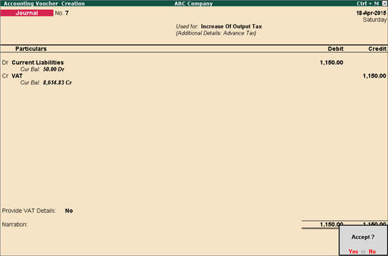

You can create a journal voucher for the increase in output tax.
2. Click J : Stat Adjustment to enable the required options in Stat Adjustment Details screen.
● In the Stat Adjustment Details screen,
o Select the option VAT in the Type of duty/tax field.
o Select the option Increase of Output Tax in the Nature of adjustment field.
o Select the option Advance Tax in Additional Details field.
o Press Enter to save and return to the voucher screen.
3. Debit the ledger grouped under Current Liabilities .
4. Enter the amount in the Debit column.
5. Credit the VAT ledger.
o Enter the Rate and Assessable Value in the VAT Details screen.
o Press Enter to return to voucher screen.
6. Set the option Provide VAT Details? to Yes , and enter the relevant details.
Note: The option Provide VAT Details? is provided as per state specific requirements of VAT/CST forms and annexures. In this example, Bihar is selected as the State .
7. Enter Narration , if required. The journal voucher appears as shown below:
8. Press Enter to save.
