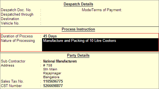

3. Party A/C Name : In this field select the Job Worker ledger on whom the Job Work Out Order is raised. For example, Global Manufacturers.
4. In Party Details screen, under Process Instruction section specify the Duration of Process and Nature of Process to be carried out.

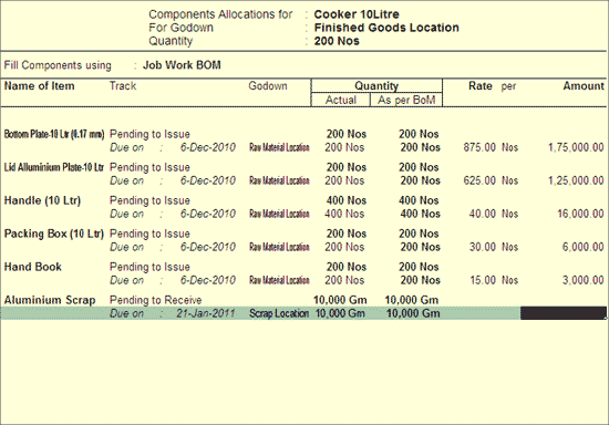

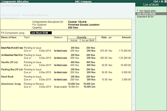

8. In Components Allocation Screen
● Fill Components using : In this field by default the BOM created for the finished goods will be displayed.
If multiple BOMs are created then Tally.ERP 9 will display the First BOM of the Item. Based on the BOM displayed the Raw materials pending for issue and By-Products/Co-products/ Scrap receivable will be displayed.
If users are issuing raw materials based on different BOM then select the appropriate BOM in this field. Here, ABC Company are issuing the Raw materials se per Job Work BOM. On selection of applicable BOM the items will be displayed with the Quantity required to manufacture 200Nos of pressure Cooker 10Litre.
Observe, when the BOM is selected by default the voucher date will be displayed as the Due on date for Raw materials and for By-Products/Co-products/Scrap the due date specified for the Finished goods will be displayed. When BOM is selected the Quantity As per BoM will be displayed automatically
● In Component Allocation screen, if the Raw material Due date is different then alter the same.
The completed Component Allocation screen is displayed as shown:

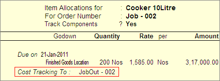

● In Stock item Allocation screen,
o Rate : In this field specify the Rate of Finished goods. For example, 1585.
o Amount : Will be calculated and displayed automatically.
o Cost Tracking To : Select New Number and specify the tracking number as JobOut - 002 .
The completed Stock Item Allocation screen is displayed as shown:
● Press Enter to save the Item Allocation screen.

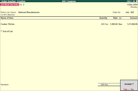

The completed Job Work Out Order is displayed as shown:
9. Press Enter to save.
