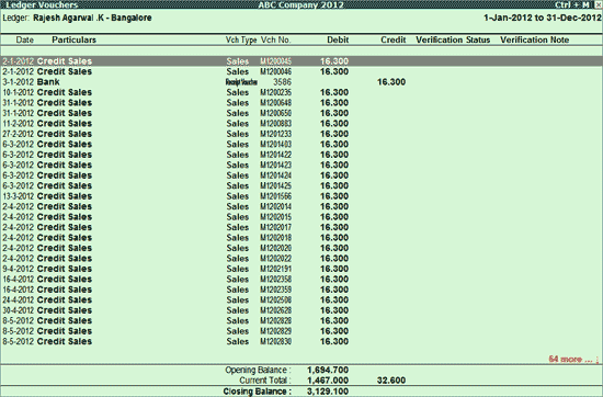

The Ledger Vouchers for the Repeated Transactions report displays those vouchers for which the amount is repeated more than once.
View Ledger Vouchers report for Repeated Transactions
Button options in Repeated Transactions - Ledger Vouchers report
1. Go to Gateway of Tally > Analysis & Verification > Data Analysis > Repeated Transactions .
2. Select the required Ledger and press Enter .
The Ledger Vouchers report displays the vouchers for which the same amount is repeated along with the other required information like Voucher Date, Particulars, Voucher Type, Voucher Number, Dr and Cr Amounts, Verification Status and Verification Note.
