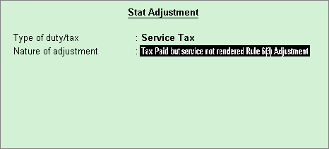

2. Click J : Stat Adjustment to enable required options in Stat Payment Details screen. In the Stat Adjustment Details screen,
o Click F12: Configure and set the option Allow All Adjustment Types to Yes .
o Select the option Service Tax in the field Type of duty/tax .
o Select the option Tax Paid but service not rendered Rule 6(3) Adjustment in the Nature of adjustment field.
o Press Enter to save, and return to voucher screen.
