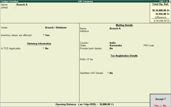

To create a Branch/Division
2. Enter the Name of the branch/division.
3. Select Branch/Division from the List of Groups in the field Under .
4. Enable the option Inventory values are affected , if required.
5. Enter the Mailing Details .
6. Select the Country to which the supplier belongs. The application will infer the nature of removal based on the country selected.
7. Select the State .
8. Enter the PIN Code .
9. Enter the bank details, if required
10. Enter the PAN.
11. Enable the option Set/Alter VAT Details , if required.
12. Enter the opening balance, if any.
The completed branch or division ledger appears as shown below:
13. Press Enter to save .
