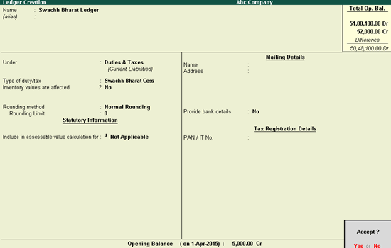

Create Swachh Bharat Cess Ledger
Create a Swachh Bharat cess ledger as shown below:
Note : If you have created a Swachh Bharat cess ledger with the Type of duty/tax selected as Others , you can change the same to Swachh Bharat Cess .

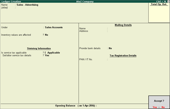

Create Sales Ledger
Create a sales ledger as shown below:

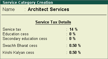

Create a Service Category
For each of the services rendered and received, a service category can be created. The service category with the service tax details should be associated with a group. Create a service category as shown below:

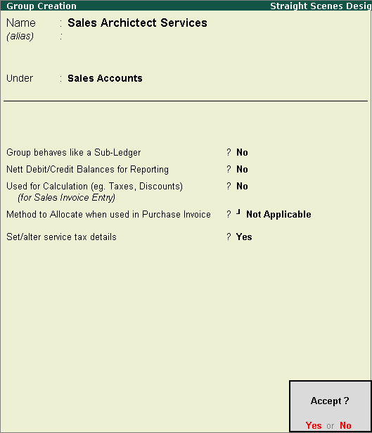

Create Group with Service Tax Details
Create a group under Sales Accounts as shown below.

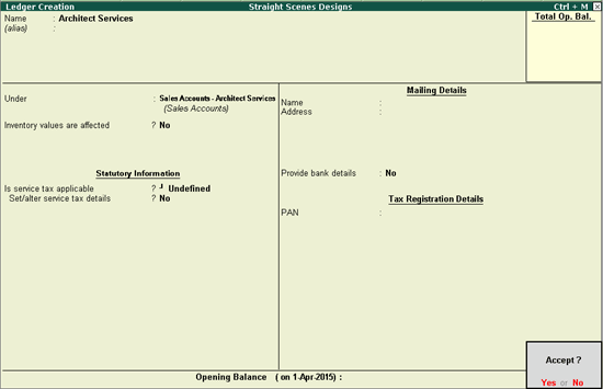

Create Ledger under the group defined with Service Tax rate
Create a ledger under the service category Architect Services as shown below. Once the ledger is associated with a category, the service tax details defined in that category is inherited.
