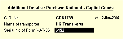

8. Set the option Provide VAT details? to Yes . In the Statutory Details screen
● Enter the purchase details as shown below:
● Press Enter to save and return to the purchase voucher.

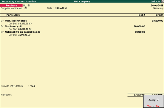

The purchase voucher appears as shown below:
9. Press Enter to save.
