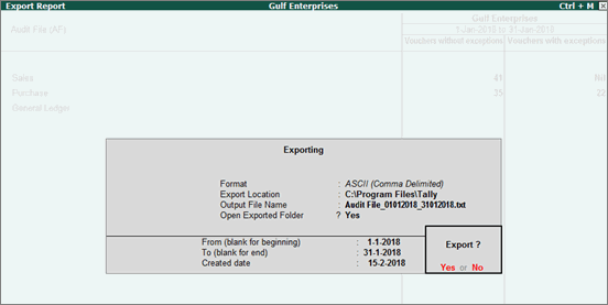

3. Press Enter from the Vouchers with exceptions column and resolve exceptions if any.
4. Press Ctrl+E to export the audit file.
5. Enter the Created date in the Export Report screen.
6. Press Enter to export.

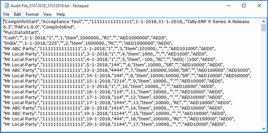

The exported audit file will appear as shown:
