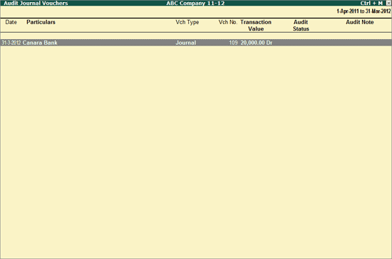

View Audit Journals
Go to Gateway of Tally > Audit & Compliance > Audit Journals .
The above report displays all the Finalisation Entries passed using the Finalisation Flag available in the Audit Journal Voucher Creation screen.
The Finalisation Flag can be used to pass the entries that will affect the Profit/(Loss) before Interest , Depreciation and Tax in the Schedule-VI Profit & Loss A/c . Profit & Loss A/c  Ledger is not available for selection when this flag is selected in the Audit Journal creation.

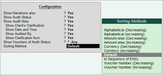

Click F12 : Configure or press F12 to change the default view of this report as shown below:
● Show Narrations also : Set this option to Yes to display the Narration entered by the Client during the voucher entry.
● Show Audit Status : Set this option to Yes to display the Audit Status as selected by the Auditor during the Audit. This option is set to Yes by default.
● Show Audit Note : Set this option to Yes to display the Audit Note as entered by the Auditor during the Audit. This option is set to Yes by default.
● Show Client's Clarification : Set this option to Yes to display the Clarification Note entered by the Client for the Vouchers marked as Need Clarification by the Auditor.
● Show Date and Time : Set this option to Yes to view the date on which, and time at which, clarification was provided for the listed Vouchers.
● Show Audited By : Set this option to Yes to view the person who has performed auditing on the Vouchers.
● Show Clarification from : Set this option to Yes to view the user who has provided clarification, if any, for the Vouchers.

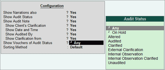

● Show Vouchers of Audit Status : Select an Audit Status and the Vouchers that have been marked with the chosen Audit Status will be filtered and displayed.
● Sorting Method : Select the required sorting method -Alphabetical, Amount-wise, Currency-wise, Default, Sequence of Entry, Voucher Number for the transactions from the list of Sorting Methods .
