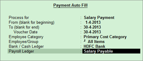

3. Click A : Payroll Auto Fill.
4. Select the Salary in Process for field.
5. Enter the From and To dates.
6. Enter the required Voucher Date .
Note: The Voucher Date can be different or outside the period specified in ( From and To fields). For example, the voucher date for salary payment for April can be 2.05.2009.
7. Select the appropriate Employee Category .
8. Select the Employee/Group from the List of Employees/Group .
9. Select the appropriate Bank/Cash Ledger from the List of Ledger Accounts .
Note: If the bank selected is enabled for e-payments in the master, you can select any of the e-payments methods
10. Select the appropriate Payroll Ledger from the List of Ledger Accounts .
Note: If the salary payment is done through cash, you can select Cash in the Bank/Cash Ledger field.

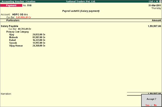

11. Press Enter to accept the Payment Auto Fill screen, and return to the payment voucher.
12. Press Enter to save.
