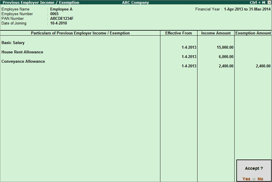

Previous Employer Income/Exemption Details
1. Go to Gateway of Tally > Payroll Info. > Income Tax Details > Previous Employer Details > Income/Exemption Details .
2. Select the required Employee from the List of Employees , and press Enter.
3. Specify the required Pay Component in the Particulars field.
4. Specify the start date in the Effective From field.
5. Specify the value in the Income Amount field.
6. Specify the value in the Exemption Amount field.
7. Press Enter to save.

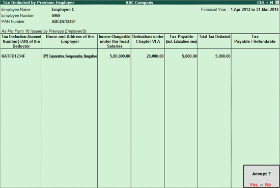

Previous Employer Tax Deducted/Paid Details
1. Go to Gateway of Tally > Payroll Info. > Income Tax Details > Previous Employer Details > Tax Deducted/Paid Details .
2. Select the required employee from the List of Employees , and press Enter.
3. Specify the Previous Employer and Tax payment.
4. Press Enter to save.
