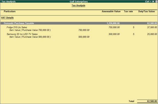

You can view the tax details by clicking A : Tax Analysis . Click F1 : Detailed to view the tax break-up.
7. Press Ctrl+A to accept.

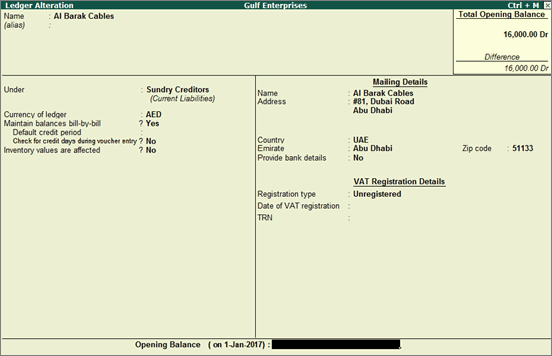

Update the party ledger to identify unregistered dealers
1. Go to Gateway of Tally > Accounts Info. > Ledgers > Alter > select the ledger.
2. Set the Registration type as Unregistered .
3. Press Ctrl+A to save.

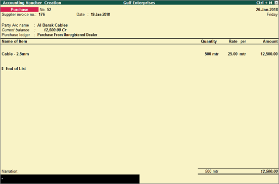

Record purchases from an unregistered dealer
2. In Party's A/c Name , select the ledger of the unregistered dealer.
3. Select the purchase ledger created with Domestic Purchases - Unregistered as the Nature of transaction .
If you are using a common purchase ledger, then based on the party ledger, the nature of transaction is inferred as Domestic Purchases - Unregistered .
4. Select the stock item, and enter the quantity and rate.
5. Press Ctrl+A to accept.

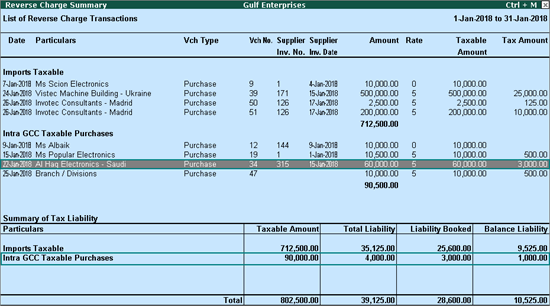

You can view the details of tax liability to be recorded for intra GCC purchases under reverse charge in the Reverse Charge Summary .

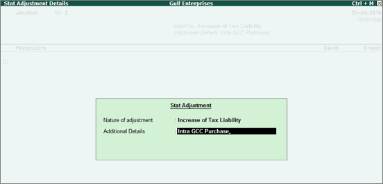

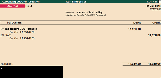

Record journal vouchers for reverse charge liability
2. Click J : Stat Adjustment .
3. Select Increase of Tax Liability as the Nature of adjustment .
4. In the Additional Details field, select the option Intra GCC Purchase .
5. Press Enter to return to journal voucher.
6. Debit the expense ledger, or the ledger grouped under Current Assets .
7. Credit the VAT ledger for the tax on intra GCC purchase under reverse charge. Enter the tax Rate and Taxable Value in the VAT Details screen displayed.
8. Press Ctrl+A to accept the voucher.

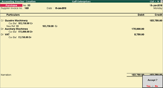

To record purchase of capital goods by claiming VAT credit fully in the same voucher
1. Go to Gateway of Tally > Accounting Vouchers > F9: Purchases .
2. Press Ctrl+V to switch to voucher mode.
o Press F12: Configure twice, set the option Allow expenses/fixed assets in purchase vouchers? to Yes .
o Press Ctrl+A to return to voucher screen.
3. Enter Supplier Invoice No. and Date .
4. Credit the party ledger and enter the amount.
5. Debit the fixed assets ledger (grouped under Fixed Assets and with Domestic Taxable Purchase - Capital Goods selected as the Nature of transaction ) and enter the taxable value.
The VAT Details screen appears with VAT Rate , Taxable Value and Tax Amount . The column Claim Credit will be set to Yes .
6. Press Enter to return to the voucher.
7. Debit the VAT ledger.
8. Accept the voucher.

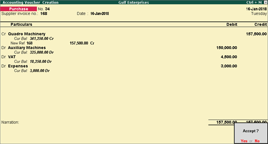

To record purchase of capital goods with partial claim of input credit

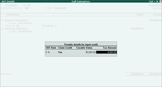

The VAT Details screen appears with VAT Rate , Taxable Value and Tax Amount . The column Claim Credit will be set to Yes . Enter the Taxable Value on which input credit will be claimed.
7. Debit the VAT ledger and enter the tax credit that is partially being claimed.
8. Debit the expense ledger to account for the remaining amount of tax.
9. Accept the voucher.

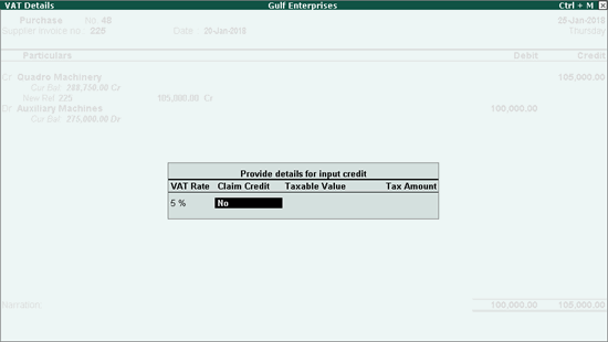

To record purchase of capital goods to claim input credit in a separate voucher
The VAT Details screen, press Backspace on Taxable Value column, and set Claim Credit to No .

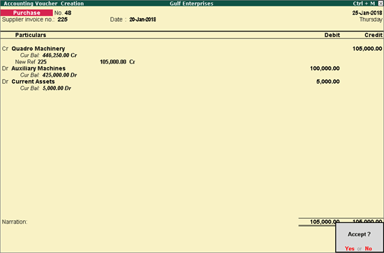

7. Debit the ledger grouped under Current Assets .

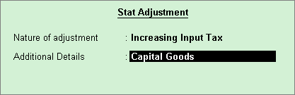

Claim input credit on capital goods purchase in journal voucher
o Select Increasing Input Tax as the Nature of adjustment .
o In the Additional Details field, select the option Capital Goods .
o Press Enter to return to journal voucher.

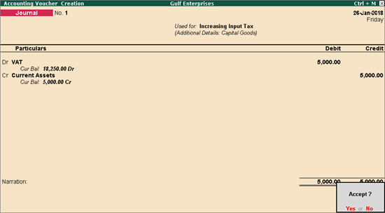

3. Debit the VAT ledger for the tax on capital goods purchase. Enter the VAT Rate and Taxable Value in the VAT Details screen displayed.
4. Credit the ledger grouped under Current Assets that was used during capital goods purchase to account for input credit.
5. Press Ctrl+A to accept the voucher.
