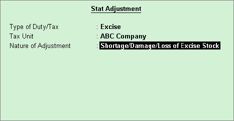

2. Click J : Stat Adjustment to view the Stat Adjustment Details screen.
3. Select the Type of Duty/Tax as Excise .
4. Select the Tax Unit from the list.
5. Select the Nature of Adjustment as Shortage/Damage/Loss of Excise Stock .
The completed Stat Adjustment Details screen appears as shown below:

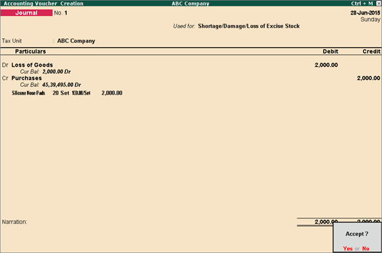

6. Debit the expense ledger (grouped under Direct Expenses , Is Excise Applicable is set to Not Applicable ).
7. Enter the amount.
8. Credit the purchase ledger to reverse the purchase cost.
9. Press Enter to view Inventory Allocations screen.
10. In the Inventory Allocations screen, select the name of the item.
11. Press Enter to view the Supplier Details screen.
12. Provide the details.
13. Enter details in Stock Item Allocations screen.
14. P ress Enter . The item details are displayed in Inventory Allocations screen.
15. Press Enter to accept.
