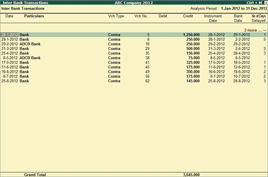

The Inter Bank Transactions report provides the details of all transactions carried out between the banks during the analysis year.
View the Inter Bank Transactions report
Button options in Inter Bank Transactions report
Configuration Options
Go to Gateway of Tally > Analysis & Verification > Data Analysis > Inter Bank Transactions .
The above report displays the details of Inter Bank transactions along with Voucher Type , Voucher Number , Debit and Credit balances, Instrument Date , Bank Date , Number of Days delayed, Verification Status and Verification Note .
Note: The No. of Days Delayed will be displayed based on the Date of Instrument and the date on which it was cleared (Bank Date). If the Bank Date is not mentioned the last day of the Analysis Period will be considered as Bank Date (31st March) for calculating No. of Days delayed.
