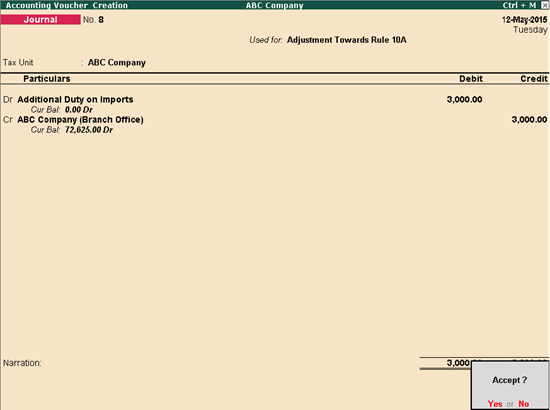

To record an adjustment towards Rule 10A
2. Click J : Stat Adjustment .
3. Enter the Type of Duty/Tax , Tax Unit , and Nature of Adjustment in the Stat Adjustment Details screen.
4. Press Enter .
5. Press Enter to accept the Tax Unit .
6. Debit the required duty ledger.
7. Credit the required duty ledger.
8. Enter the Narration , if required.
9. Press Enter .
The completed adjustment entry is as shown below:
10. Press Enter to save.

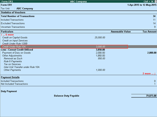

Viewing in Return Forms
The adjustment entry recorded using the flag Adjustment Towards Rule 10A is displayed under CENVAT Credit Availed .
The detailed view of the return form appears as shown below:
Similarly, in the books of the branch unit, the amount will be displayed under Cenvat Credit Utilized.
Press Enter on Credit Under Rule 10A to view the CENVAT credit Availed report.
