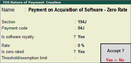

To create a nature of payment for the exempt purchase of software product
1. Go to Gateway of Tally > Accounts Info. > Statutory Info. > TDS Nature of Pymts > Create .
2. Enter the Name of the nature of payment.
3. Enter 194J and 94J in the fields Section and Payment Code , respectively.
4. Set the option Is software royalty? to Yes .
5. Enter the Rate of tax as 0% .
6. Set the option Is zero rated? to Yes .
7. Enter the amount up to which tax should not be applied for this category in the field Threshold/exemption limit , if any.
8. Press Enter to save.

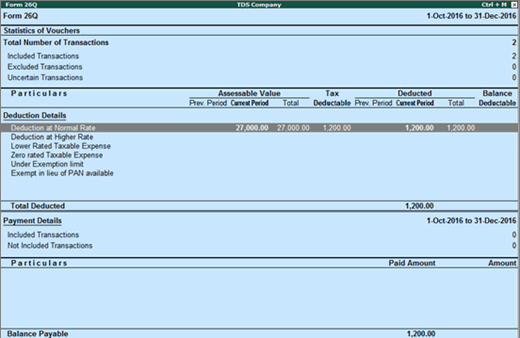

10. Press Enter to save.
The value from both taxable and exempt transactions will be updated in Form 26Q. However, in the returns file, the value from exempt transaction is flagged with the initial S , indicating software purchase.
