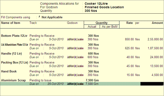

● Press enter from Quantity field to view Components Allocation screen.
Note :
1. Component Allocation screen will be displayed only when the option Track Components is set to Yes in Stock Item Allocation screen.
2. The Finished goods for which Job Work In order is raised does not have the Bill of Material (BOM) then in Component Allocation screen, Tally.ERP 9 will skip Fill Component using field and cursor will be displayed in Name of Item field indicating that the Raw Materials required for the manufacture of Finished goods have to be selected from the List of Stock Items.
● I n Components Allocation Screen,
o Name of Item : Select the Raw materials required to manufacture the finished Goods. For example, Bottom Plate-12Ltr.
o Track : In this field select Pending to Receive from the Type of Component list as the Raw materials have to be received from the Principal Manufacturer.
o Due on : In this field specify the date on which the Raw materials will be received. By default the Voucher Date will be displayed in this field. if the Receipt Date is different than the voucher date, specify the correct Due on date. Here, ABC Company is receiving the Raw materials on 5-10-2010.
Note : If the Principal Manufacture is delivering the raw materials in Installments then user can define multiple Due on date with Quantity of delivery.
Example : 100 Nos on 5-10-2010 and 200 Nos on 10-110-2010
o Godown : In this field select the godown where the Components/ Raw materials will be stored.
o Quantity (Actual) : In this section specify the Quantity of Raw materials to be received.
Note : Cursor will not move to As per BOM field when the BOM is not selected in Fill Component using field.
o Rate : In this field specify the Rate of Raw material received for the manufacture of finished goods.
● Similarly, select all the Raw materials to be received towards the Job work In Order .
● In the process of Manufacture of Cooker 12Litre, Aluminium Scrap is produced. Under Name of Item select Aluminium Scrap and in Track field select Pending to Issue as the scrap has to be issued (sent back) to the Manufacturer along with the Finished goods.
Note : While recording the Job Work Out Order users can also track the Scrap, By-Products or Co-products produced during the manufacture of Finished goods.
● In Due On field specify the Date on which the scrap will be sent back, Here, Job Worker is Β sending the scrap along with the Finished Goods on 25-10-2011 .
● In Godown field select the Godown where the scrap will be stored. E.g. JobWork (In) Location
● In Quantity (Actual) field specify the Quantity of scrap to be received. e.g. 7,500 Gm
The completed Components Allocation screen is displayed as shown:
