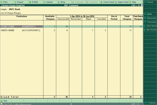

● Drill down from the Cheque Register report to view all the cheque ranges in the Cheque Range Register screen.
o Further drill down to each cheque range to view the cheque details.
o Click F4: Bank to toggle between banks, and view the cheque range set for the selected bank. Click C: Cheque Range to toggle between different cheque ranges.
o Not in range - Drill down to view details of the cheques that are issued but not set as part of any cheque range.

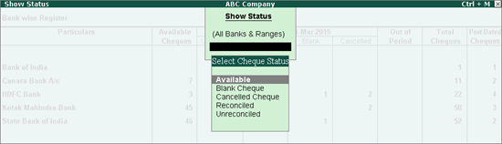

Status-wise view of cheques
● Click F6: View All and select the status for which you want to view the cheque details on a single screen.
● Click F5: Status-wise to view the list of cheques displayed under different statuses on a single screen.
