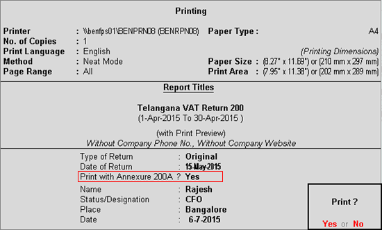

You can open Form VAT 200 and enable Print with Annexure 200A in the Printing screen for printing the Form 200A for Telangana.
To generate Form VAT 200A
1. Go to Gateway of Tally > Display > Statutory Reports > VAT > Form VAT 200 .
2. Press Ctrl+P .
3. In the Printing screen, enter the other required details.
4. Press Enter to print Annexure 200A .
