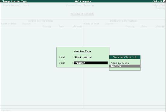

Tally.ERP 9 allows you to transfer materials from one Godown to another. The transfer of materials is done using the Transfer Journal Voucher.
To create stock journal for inter - godown transfers,
1. Go to Gateway of Tally > Inventory vouchers > Alt+F7 for Stock Journal and select the class.
2. Pass the stock transfer entry.

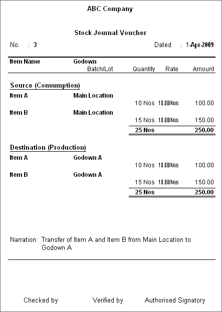

Printing Stock Transfer Voucher
To print stock transfer vouchers
1. Press Alt+P to print the Stock Transfer Journal Voucher.

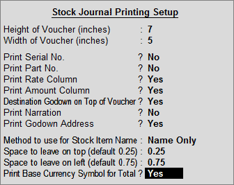

F12: Print Configuration

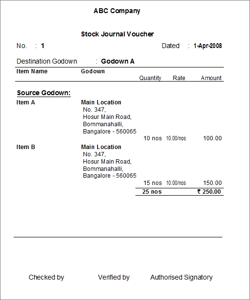

● While printing Stock Transfer Voucher, set the options Destination Godown on Top of Voucher and Print Godown Address to Yes .
● Enabling the option Destination Godown on Top of Voucher will display the Destination Godown name on the top of the voucher instead of printing as separate rows
● Enabling the option Print Godown Address will display the godown address as mentioned in the Godown Creation/Alteration screen.
