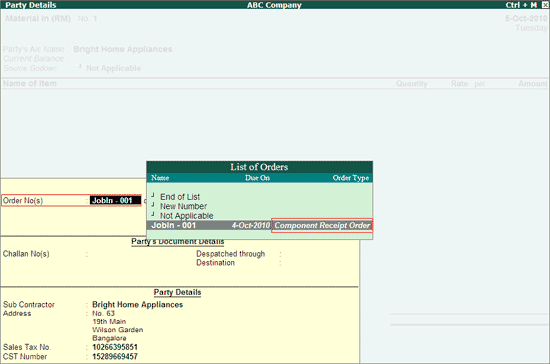

4. Party A/C Name : In this field select the Principal Manufacturer ledger from whom the material are received. E.g. Bright Home Appliances . Press Enter to view Party Details screen.
5. In Party Details screen,
● Under Order Details , in Order No(s) field select the Job Work In Order from the List of Orders towards which the Raw materials are received.
Note : The Order Type in List of Orders will be displayed as Component Receipt Order indicating that this order is selected to account the receipt of components.
● Under Name of Item the stock items will be auto-filled based on the Job Work In Order selected.
● Source Godow n: In this field select Not Applicable , as we are receiving the components from the principal Manufacture.

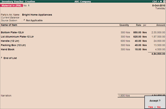

The completed Material In Voucher is displayed as shown:
Note : Observe, Tally.ERP 9 displays only the Raw material required for the Manufacture of finished goods. For Job Order JobIn - 001 we have identified that during manufacturing process Aluminium Scrap will be produced, which is not auto filled for material transfer in.
6. Press Enter to save.

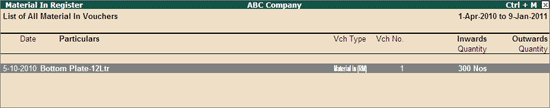

The details of Material Transfer In voucher details can be viewed in Material In Transfer.
To view the Material In Transfer
1. Go to Gateway of Tally > Display > Job Work In Reports > Job Work Registers > Material In Transfer

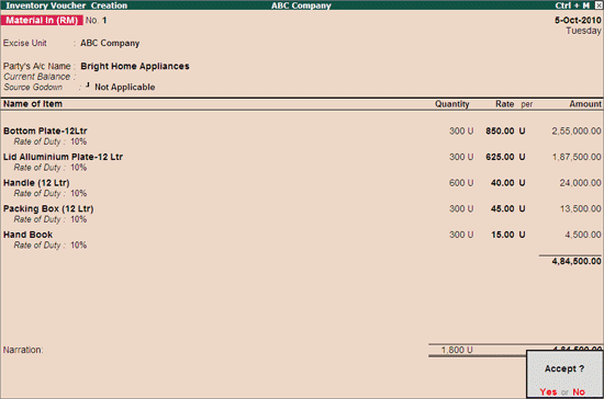

1. Go to Gateway of Tally > Inventory Vouchers > Ctrl + W: Material Transfer In
2. In Change Voucher Type screen select Material Transfer In (RM) from the List of Types
1. Enter the Date as 5-10-2010
2. Party A/C Name : In this field select the Principal Manufacturer ledger from whom the material are received. E.g. Bright Home Appliances. Press Enter to view Party Details screen
3. In Party Details screen,
● Under Order Details , in Order No(s) field select the Job Order from the List of Orders towards which the Raw materials are received - JobIn Ex - 001.
● Under Name of Item the stock items will be auto-filled based on the Job Order selected.
● Source Godown : In this field select Not Applicable as the goods are received form the Principal Manufacturer.
