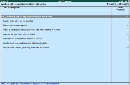

Vouchers with incomplete/mismatch in information list includes voucher that contain VAT related information but are not included in the count of Included in returns/annexures and Not relevant for returns/annexures .
You can identify the exceptions and correct the transactions before filing tax returns. Based on the state selected the VAT report appears. The Vouchers with incomplete/mismatch in information report for VAT Form-3 of Bihar appears as shown below:
The exceptions are listed in the order of priority, based on the importance of the information for generating returns and annexures. Hence, a voucher with multiple exceptions is listed in the exception type higher up the order. Once that exception is resolved, the voucher will move down to the next exception type. Such vouchers with multiple exceptions continue to be listed as exceptions until all incomplete/mismatch information is resolved. This will help you clear all exceptions before filing the returns.
However, vouchers with only one exception are moved to Included in returns/annexures list after that exception is resolved.
No. of voucher with incomplete/mismatch in information
Displays the count of total vouchers with exceptions. Drill down from this row to view all the vouchers with exceptions, number of exceptions in each voucher, and type of exception.
To resolve all exceptions without having to go from one exception type to another
1. Select No. of voucher with incomplete/mismatch in information .
2. Press Enter to display Exception Resolution screen with the list of vouchers, number of exceptions in each voucher, and exception types. The Exception Resolution screen appears as shown below:
3. Select any transaction and press Enter to display the Voucher Details Alteration screen which is divided into multiple sections, one for each exception in the voucher, as shown below:
4. Select or enter required information for the first exception type. Further, you can click F5: Recompute or A : Accept as is to recompute or accept the details, respectively.
5. Press Enter to navigate to next exception type.
6. Resolve the exceptions by providing details or using the buttons provided.
7. Press Enter after all exceptions in the voucher are resolved to view the next voucher with respective exceptions.
8. Continue resolving the exceptions voucher by voucher, or press Esc to return to Exception Resolution screen.

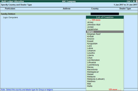

Country and dealer type not specified
Displays the count of transactions where,
● Country/state is not selected in the party ledger master,
● State selected in transaction and party ledger are different, or
● Nature of transaction is not derived.
To resolve this exception
1. Select the exception Country, state and dealer type not specified/mismatch .
2. Press Enter . All the transactions of the exception type are displayed. The Exception Resolution screen appears as shown below:
3. Select the country, state  or dealer type for each transaction.
4. Press Ctrl+A to accept.

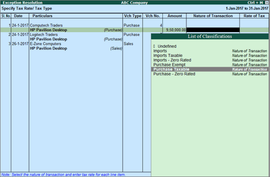

Tax rate/tax type not specified
Displays the count of transactions for which the rate or tax type is not selected in the item/ledger master.
1. Select the exception Tax rate/tax type not specified .
3. Select the Nature of transaction , if not provided.
4. Enter Rate of Tax , as required for each transaction.
5. Press Enter to save.
Note: Click X : Exclude Vouchers to exclude the voucher from forms and annexures.

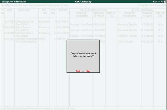

Nature of transaction, assessable value, rate of tax modified in voucher
Displays count of transactions in which the Nature of transaction , assessable value or rate of tax defined in the ledger master has been changed in the transaction.
1. Select the exception Nature of transaction, assessable value, rate of tax modified in voucher .
2. Press Enter . All the transactions of the exception type are displayed, as shown below:
3. Select the required voucher.
4. Click R : Resolve to select Nature of transaction and enter other details manually, or click A : Accept as is . A message is displayed as shown below:
5. Press Enter to accept.
6. Similarly, accept the required vouchers.
7. Press Ctrl+A to accept.

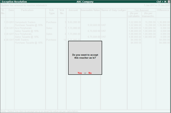

Mismatch due to tax amount modified in voucher
Displays the count of transactions in which difference is found between the calculated and entered tax amount. Also, if the difference is higher than round-off value . The mismatch due to modified value can be resolved by following one of the options.

Accept as is
1. Select the exception Mismatch due to tax amount modified in voucher .
2. Press Enter . All the transactions of the particular exception are displayed.
3. Select the required voucher and click A : Accept as is . A message is displayed as shown below:
4. Press Enter to accept.
5. Similarly, accept the required vouchers.
6. Press Ctrl+A to accept.

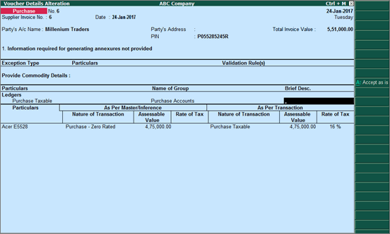

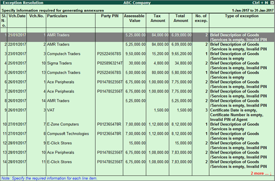

Information required for generating annexure not provided
Displays the count of transactions excluded from annexures due to incomplete information required for annexures. The button Exception Types is provided to resolve all party ledger level or voucher level corrections from a single screen.
1. Select Information required for generating annexure not provided .
2. Press Enter to display Exception Resolution screen with list of vouchers with mismatch/incomplete information.
3. Select any voucher and press Enter to display the Annexure exceptions(s) screen, as shown below:
4. Enter the missing information or update the incorrect details, and press Enter to return to the Exception Resolution screen .
5. Select the next voucher to update the details required for annexures and continue.

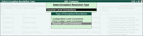

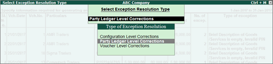

Exception Types
Using this option you can resolve exceptions from a common screen by grouping all annexure related exceptions into two buckets Party Ledger level Corrections and Voucher Level Corrections . Exceptions in each group can be resolved from a single screen without having to move voucher by voucher.

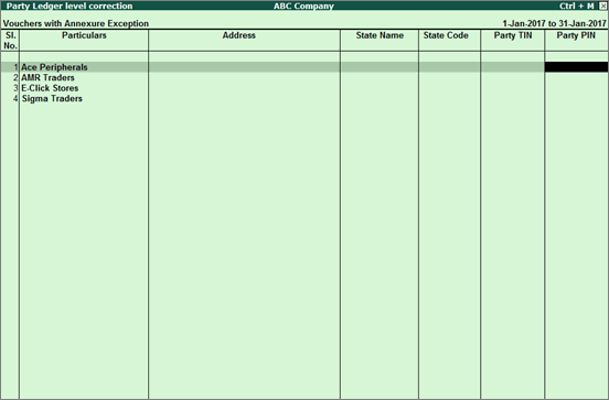

To resolve all party ledger level exceptions
3. Press Ctrl+E .
4. Select Party Ledger Level Corrections in the Select Exception Resolution Type screen.
5. Enter Party TIN number for the listed parties in the Party Ledger Level correction screen, as shown below:
To resolve all voucher level exceptions
3. Press Ctrl+E .
4. Select Voucher Level Corrections in the Select Exception Resolution Type screen.
5. Enter PIN of Agent for the listed vouchers.

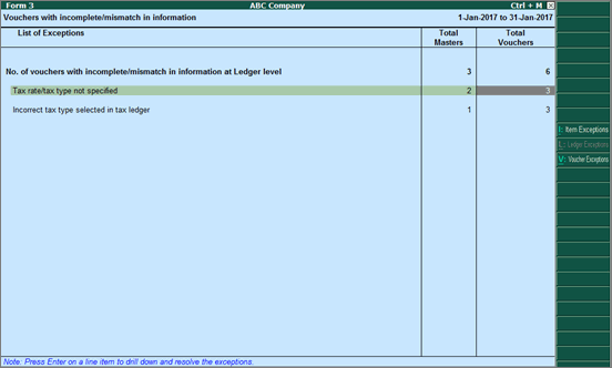

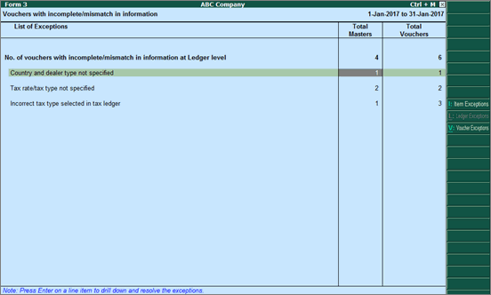

Filter for Item level and Ledger level exceptions
By default, the list of exceptions displays incomplete/mismatch information details voucher-wise. However, the button options provided in the report allow you to view the exceptions item master-wise or ledger-wise. In item master-wise view, all exceptions caused by an item can be resolved by updating missing or incorrect information from a single screen. This will result in resolving multiple voucher exceptions caused by the particular master. Similarly, all exceptions caused by a particular ledger can be resolved from ledger-wise exceptions list.
Item Exceptions
Click I : Item Exceptions to alter view of Vouchers with incomplete/mismatch in information report to display vouchers with incomplete/mismatch of information in item master. The vouchers with exceptions are displayed against different exception types in 2 columns:

L : Ledger Exceptions
Click L : Ledger Exceptions to view of Vouchers with incomplete/mismatch in information report displays vouchers with missing/mismatch of information in ledger master. The vouchers with exceptions are displayed against different exception types in 2 columns:
Total Masters
Drill down from this column to view information missing/mismatch at ledger master level. You can provide the required details at ledger group level to update all ledgers in the group or at individual ledger level. By providing required information at leger master level, all voucher level exceptions resulting from that ledger are resolved.
