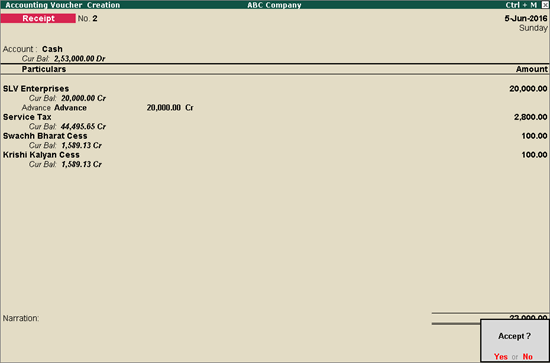

To record receipt voucher for advance received
1. Go to Gateway of Tally > Accounting Vouchers > F6: Receipt .
2. Select cash or bank ledger in Account field.
3. Select the party ledger from whom advance is received under Particulars .
4. Enter the value in Amount field and press Enter to display Bill-wise Details screen.
o Select Advance from Method of Adj. list in Type of Ref field.
o Enter a Name for the advance.
o Press Enter to save the amount and return to voucher screen.
5. Select service tax ledger and press Enter to display Service Tax Allocation screen.
o Select the Category .
o Press Enter to accept. Service Tax gets calculated as per the rate defined in the category master.
6. Select the swacch bharath cess ledger, and press Enter to accept the amount displayed.
7. Select the krishi kalyan cess ledger, and press Enter to accept the amount displayed.
The receipt voucher appears as shown below:
8. Press Enter to save.

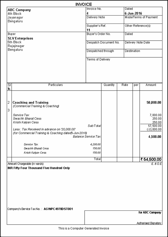

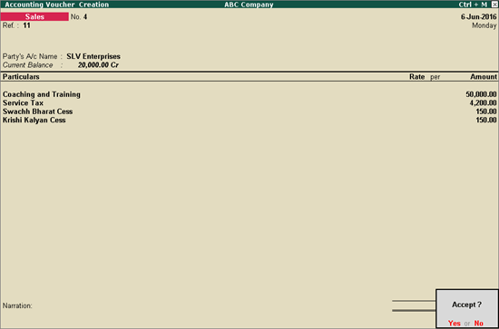

To record a sales invoice for the advance received
1. Go to Gateway of Tally > Accounting Vouchers > F8: Sales > I : Acct Invoice .
2. Click F12: Configure .
o Set the option Use defaults for bill allocations? to No .
o Press Ctrl+A to accept.
3. Select the party from whom advance was received in the Party's A/c Name field.
4. Select the ledger of the service being provided under Particulars .
5. Enter the sales value in the Amount column.
6. Select service tax ledger and press Enter to accept the amount that appears.
7. Select Swacch Bharath cess ledger and press Enter to accept the amount that appears.
8. Select Krishi Kalyan cess ledger and press Enter to accept the amount that appears.

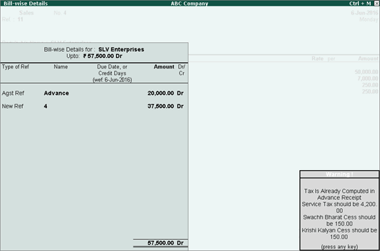

9. Press Enter to display the Bill-wise Details screen.
o Select Agst Ref from Method of Adj. list in Type of Ref field.
o Select the advance receipt bill from Pending Bills list in Name field.
o Select New Ref from Method of Adj. list in Type of Ref field.
o Enter the Name for the new ref.
o Press Enter to accept value in the Amount field.
A message appears to inform about the tax computed in advance receipt as shown below:
o Press Enter to revert to voucher screen.
Note: To avoid this warning message, do not accept the tax amount computed in the voucher but calculate tax value by considering the tax applied in advance voucher and enter manually.
10. Modify the tax amount as per the value displayed in the message.
11. Press Enter to display the Bill-wise Details screen.
12. Press Enter to save.
13. Press Page Up to open the invoice in alteration mode.
14. Click P : Print .
15. Press Enter in the Voucher Printing screen to print.
The print with service tax computed less tax amount in advance receipt appears as shown:

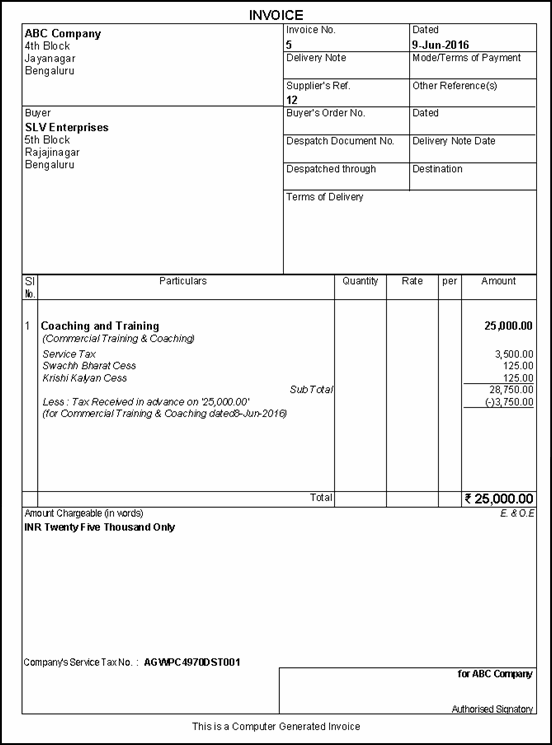

To record a sales invoice for the full advance received

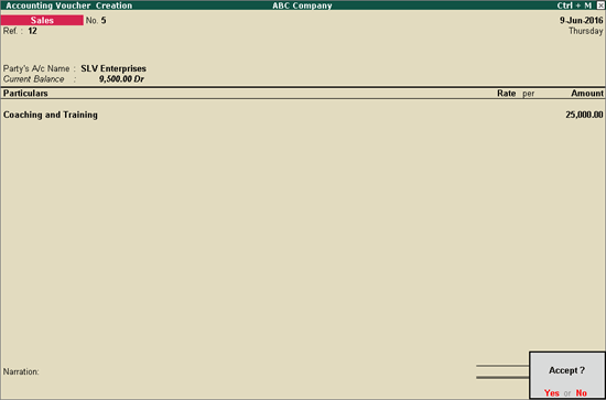

2. Select the party from whom advance was received in the Party's A/c Name field.
3. Select the ledger of the service being provided under Particulars .
4. Enter the sales value in the Amount column.

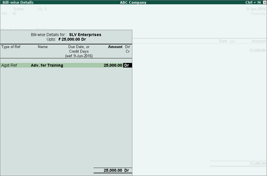

5. Press Enter to display the Bill-wise Details screen.
o Press Enter to accept value in the Amount field and revert to voucher screen.
Note: Service tax is fully applied in advance receipt, in this case tax ledgers are not selected in the sales invoice.
6. Press Enter to save.
7. Press Page Up to open the invoice in alteration mode.
8. Click P : Print .
9. Press Enter in the Voucher Printing screen to print.
The print with service tax computed in advance receipt appears as shown:
