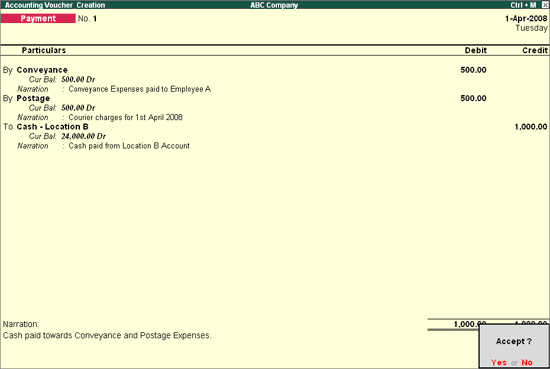

Provide narration for each ledger in voucher option is available for all Accounting Voucher Types. ย Given below is an example of a Payment transaction with narrations for each entry enabled:
The above entry consists of both common narration and narrations for each entry. ย In case of multiple debit/credit entries, you can give single line narration separately for every ledger account selected.
