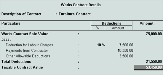

7. Enter the required details in Deduction Claimed for Tax Calculation screen. The Deduction Claimed for Tax Calculation screen appears as shown below:
8. Press Enter to save and return to the purchase invoice.

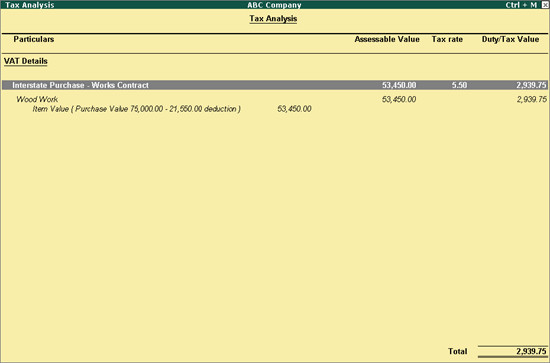

9. Click A : Tax Analysis to display the Tax Analysis screen.
o Click F1 : Detailed to view in detailed mode. The Tax Analysis screen appears as shown below:
o Pres Esc to return to the purchase invoice.

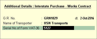

10. Set the option Provide VAT details? to Yes , and enter the Statutory Details , as shown below:
11. Press Enter to save and return to the purchase invoice as shown below:
