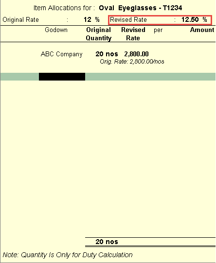

9. Enter 12.5% in the field Revised Rate.
10. Select the Godown .
11. Enter 2800 in the field Revised Rate . As there is no difference in item rate, the field Amount is blank.
The Item Allocations screen appears as shown below:
12. Press Enter .

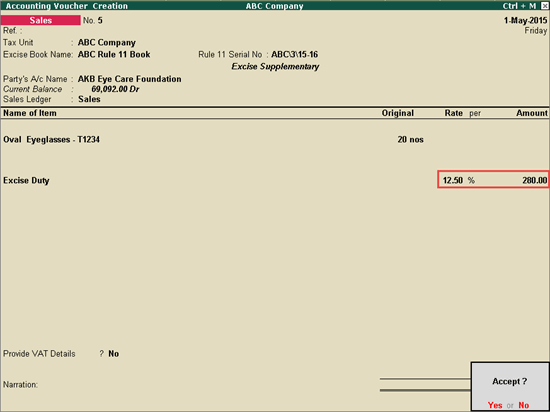

The supplementary invoice appears as shown below:
The difference in duty amount is displayed as excise duty in the supplementary invoice.
13. Press Enter to save.

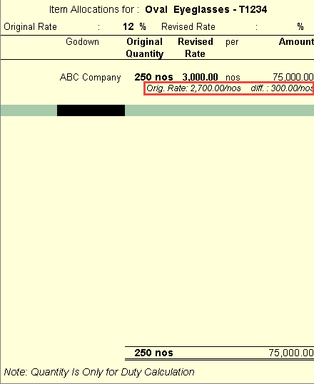

10. Enter 3000 in the field Revised Rate . The amount is calculated automatically.
11. Press Enter to save.
