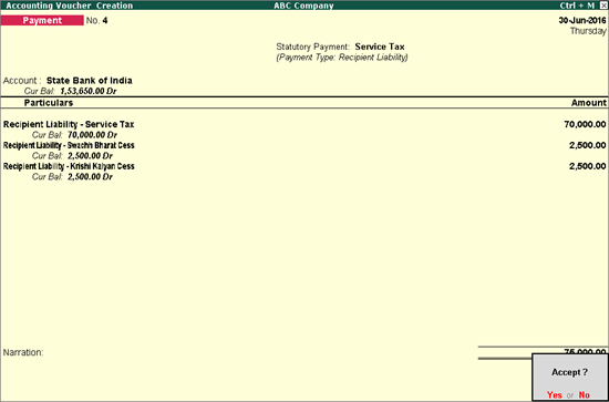

The payment invoice appears as shown below:
12. Press Enter to save.
