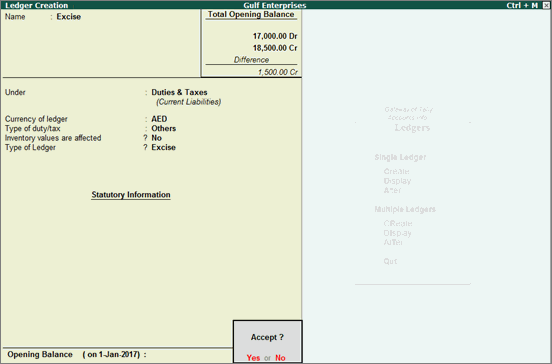

Create excise duty ledger
2. In the Ledger Creation or Ledger Alteration screen, click F12: Configure and enable the option Allow allocation of ledgers for excise?
3. Press Ctrl+A .
4. Enter the Name of the ledger .
5. Select the group Duties & Taxes in the Under field.
6. In the Type of duty/tax field, select the option Others . A new field Type of Ledger appears when the option Others is selected.
7. In the Type of Ledger field, select the option Excise .
8. Save the ledger.

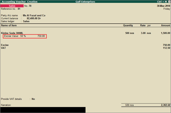

Record transactions to calculate excise and VAT
2. In the sales invoice, click F12: Configure and enable the option Allow calculation of excise duty?
3. Select the customer ledger and the sales ledger.
4. Select the excise applicable item under Name of Item and enter the quantity and rate.
5. In the Excise Value field, enter the excise rate or excise amount. When you enter the rate, excise amount appears next to the rate.
6. Select excise duty ledger created by selecting Excise as the Type of Ledger . Excise amount appears automatically.
7. Select VAT ledger. VAT is calculated based on the value of the item plus excise. The VAT amount appears automatically.
8. Save the invoice.
