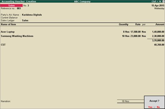

Interstate Sales at Multiple CST Rates
To record an interstate sales invoice for items attracting multiple CST rates
2. Enter the reference number in Reference no. field.
4. Set the option Is Against C Form? to No in the Party Details screen. This option appears only when the state selected is other than the State selected in the Company VAT Details screen.
5. Select a common sales ledger in which the option Is VAT/CST Applicable? is set to Applicable , and the option Set/Alter VAT Details? is not enabled.
6. Select the required stock items whose VAT rates are specified either at the stock group level, or at the stock item level. Enter the Quantity and Rate for each stock item.
7. Select the common CST ledger.
● The ledger must be grouped under Duties & Taxes in which the options:
o Type of Duty/Tax is set to CST .
o Percentage of Calculation is set to 0 .
8. Click A : Tax Analysis to display the Tax Analysis screen.
o Click F1 : Detailed to view in detailed mode. The Tax Analysis screen appears as shown below:
o Press Esc to return to the sales invoice.
9. Press Enter to save.
