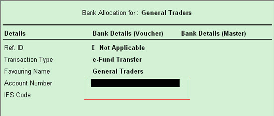

3. Press Enter to view the Bank Allocation screen, as shown below:
4. Provide the missing information in the Bank Details screen , and press Enter . For example , in the following screen Account Number and IFS Code have been entered.
5. While saving the details, you can do one of the following:
● Press R to replace master details with bank details specified in the voucher.
Note: The R: Replace button is displayed if bank details have been specified in the master. You can use this button to replace the details specified in master with the details specified in the voucher.
● Press A to accept the transaction with the information you entered.
● Press U to accept the transaction and also update your master ledger.
● Press N if you wish to make any change to the Bank Details (voucher) .
