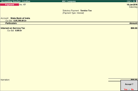

You can record the payment of interest towards service tax using the Stat Payment button in payment invoice and selecting the payment type as interest.
For example , ABC Company had to pay ₹ 800 towards service tax interest.
To record interest payment towards Service Tax
2. Click S : Stat Payment and provide the required details.
3. Select bank ledger in the field Account .
4. Select the expense ledger created for interest on service tax under Particulars .
5. Enter the Amount as 800.
6. Enter the Bank Allocation details, as applicable.
7. Enter Narration , if required.
The payment invoice appears as shown below:
8. Press Enter to save.
