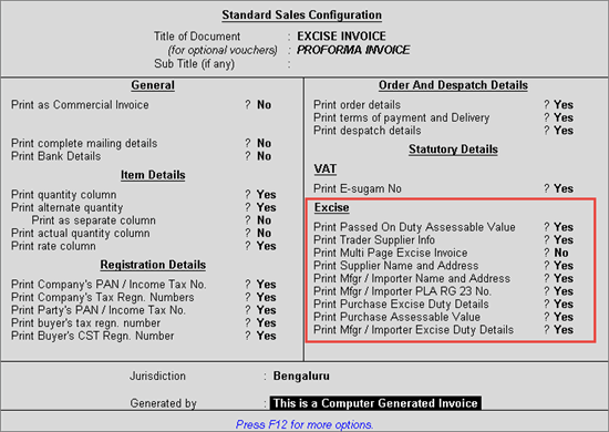

To print Rule 11 invoice
1. Press P : Print button. To generate a preview, click I : With Preview button.

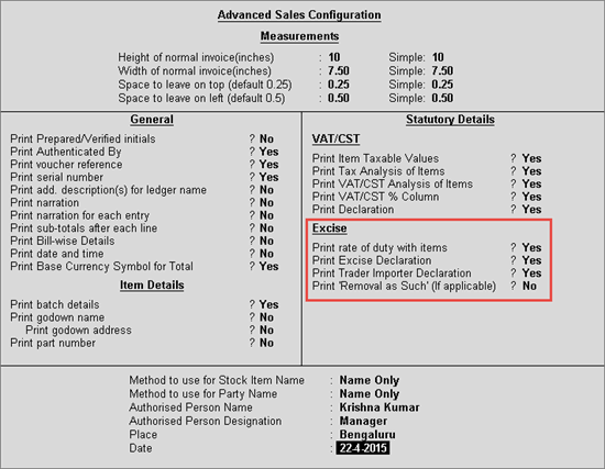

2. Click F12: Configure and enable the options as shown below:
3. Press F12 and set the options as shown below:
4. Accept the Invoice Print Configuration screen. The Voucher Printing screen appears as shown below:
5. Press Enter to print invoice in Rule 11 invoice format.

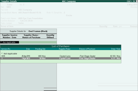

10. Select the stock item. The Supplier Details screen appears.

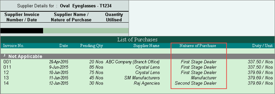

11. Click F12: Configure of Supplier Details screen and set the option Show Nature of Purchase to Yes .
The Supplier Details screen appears with Nature of Purchase column as shown below:
12. Select the required purchase bills.

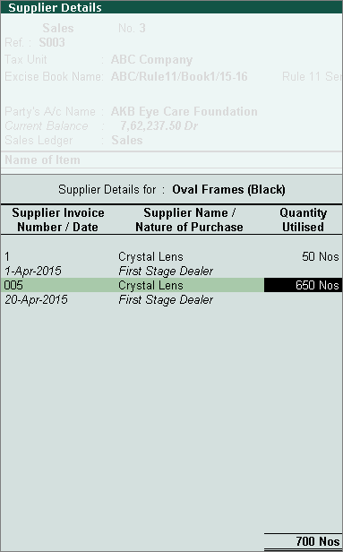

The Supplier Details screen with different purchase bills appears as shown below:
13. Accept the Supplier Details screen.

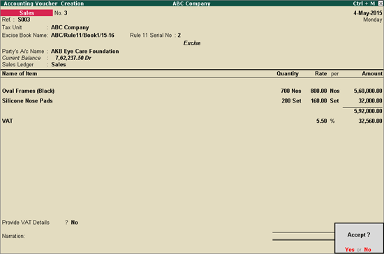

14. Select the VAT ledger.
15. Set Provide VAT Details option to Yes/No as per requirement.
16. Accept the sales invoice.
