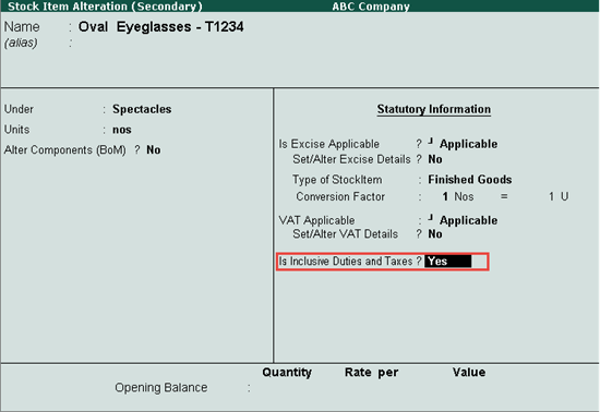

To activate sales inclusive of tax in the stock item
1. Click F12: Configure in the stock item master.
2. Enable the option Allow inclusive of tax for stock items .
3. Press Ctrl+A .
4. Enable the option Is Inclusive of Duties and Taxes .
The stock item master appears as shown below:

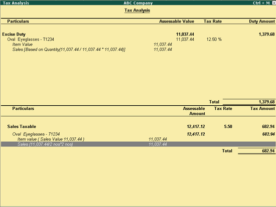

10. Click A : Tax Analysis to view the calculation of duties.
Based on the duty rates defined, excise duty and VAT have been calculated.
