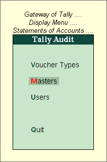

To display the Tally audit statistics for Masters , execute the following steps:
1. Go to Gateway of Tally > Display > Statement of Accounts > Tally Audit > Masters .

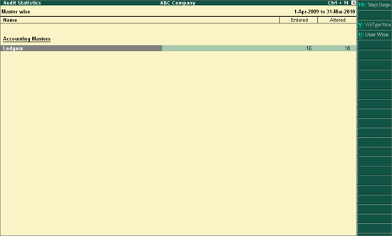

The Tally Audit Statistics screen showing the Audit Statistics for Masters is displayed as shown
Note: Currently, only Ledger Masters are available under the head Accounting Masters
Button Bar options Available in Master Wise Audit Statistics
1. F6: Today's Changes : It gives the list of voucher alteration that are made Today
2. V : Vch Type Wise : This enables you to switch to Voucher Type wise Audit Statistics
3. U : User Wise : This enables you to switch to User Wise Audit Statistics

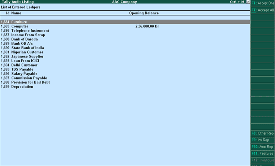

1. When drill down from the Master Wise report Name column, it will display the Tally Audit Listing for the List of Entered/Altered Ledgers as shown
2. When drill down from the Master Wise report Entered column then List of Entered Ledgers will be displayed as shown
3. When drill down from the Master Wise report Altered column, the List of Altered Ledgers will be displayed as shown
4. Changes made to the Ledger Name or their Opening Balances or newly created Ledgers since the last audit are displayed in the List of New / Entered Ledgers. In case the Ledger names are interchanged, the auditor can identify this by comparing the ledger Id assigned to each ledger and comparing them to an earlier hard copy of the audit listings.
