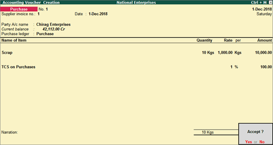

Record a purchase invoice with stock item attracting TCS, as shown below:

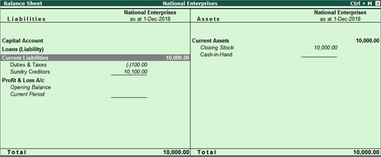

The Balance Sheet appears with values as shown below:

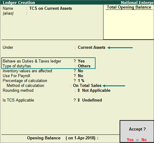

In the Ledger Creation screen, press F12 and enable the option Allow creation of tax ledgers under other groups .
Create the TCS ledger as shown below:

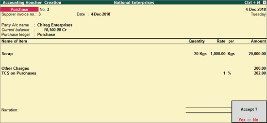

If you have to calculate TCS on additional ledgers along with stock items attracting TCS, press F12 in purchase invoice, and enable the option Calculate tax on current sub-total .
Record purchase invoice with separately charged expenses and TCS ledger as shown below:
