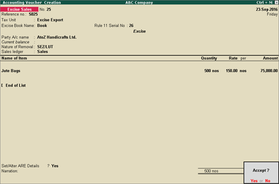

To record sales transaction for exports to SEZs
2. Select the excise sales voucher type and press Enter .
3. Enter Supplier invoice no. , if required.
4. Select the required Tax Unit . The Excise Book Name and the Rule 11 Serial No are captured by default.
5. Select the party ledger in the field Party's A/c Name . Enter the required details in Party Details screen.
6. Select SEZ/LUT in Nature of Removal .
7. Select a sales ledger where Set/Alter excise details? is not enabled.
8. Select the required stock items whose excise rates are specified either at the stock group level, or at the stock item level. Enter Quantity and Rate for each stock item.
Note: The manufacturer can select the Nature of Removal as SEZ/Bond incase the goods are being cleared under Bond. SEZ/Rebate can be selected to clear goods by charging Excise Duty.
9. Enable Set/Alter ARE Details? . Enter the details as required in the Form ARE Details sub-screen:
10. Press Enter to accept the screen and return to Voucher Creation screen.
The completed entry appears as shown below:
11. Press Enter to save.

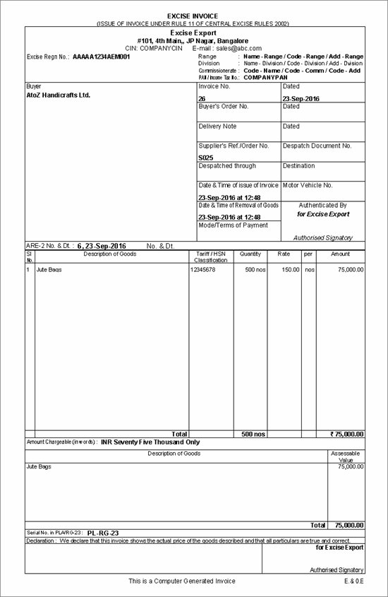

Printing Rule 11 invoice
To print Rule 11 Invoice
● Set Print ARE-2 to No i n the Voucher Printing screen.
The print preview appears as shown below:

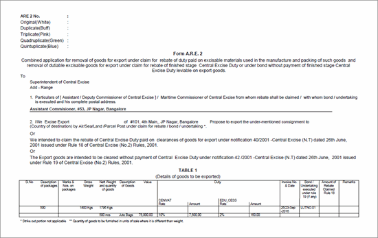

Printing Form A.R.E. 2
To print Form A.R.E 2
1. Set Print ARE-2 to Yes .
2. Enable the other required options.
Form A.R.E. 2 appears as shown below:
