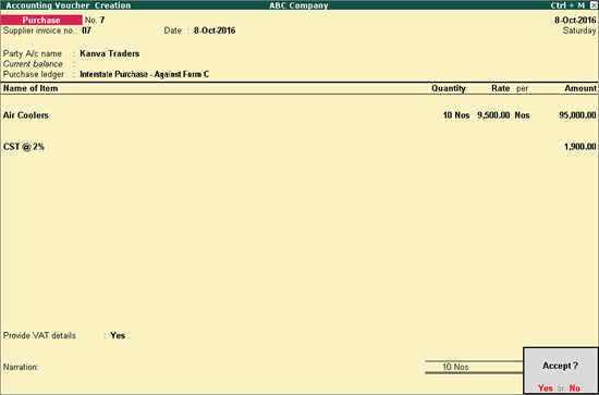

To record an invoice for interstate purchases at 2% against Form C
2. Enter Supplier invoice no. and Date .
4. Set the option Is Against C Form? to Yes in the Party Details screen. This option appears only when the State selected is other than the State selected in the Company VAT Details screen.
5. Select the purchase ledger grouped under Purchase Accounts with the Nature of transaction set to Interstate Purchase - Against Form C .
6. Select the stock item. Enter the Quantity and Rate .
Note: If the option Is Against C Form? is set to Yes in the Party Details screen, the tax gets calculated at 2% CST rate. This is irrespective of the tax rates defined in the inventory or accounting masters.
7. Select the CST ledger grouped under Purchase Accounts or Direct Expenses with the option Type of duty/tax set to CST .
8. Set the option Provide VAT Details? to Yes . Β In the Statutory Details screen
o Select the form as shown below:
Note: The options in the above screen appear based on the State selected in the Company VAT Details screen.
o Enter the relevant details.
o Press Enter to save and return to the purchase invoice.
9. Press Enter to save.
