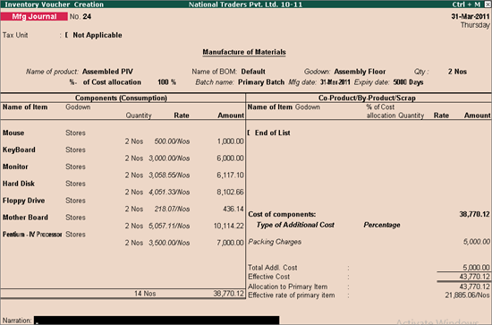

The manufacturing journal appears as shown below:
