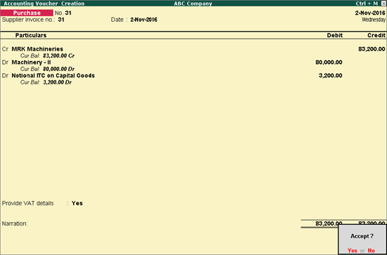

6. Debit the fixed assets ledger (grouped under Fixed Assets and with Purchase Notional - Capital Goods selected as the Nature of transaction with applicable tax rate), and enter the assessable value.
7. Debit the VAT ledger predefined with VAT as the Type of duty/tax and applicable notional tax rate. The VAT Details screen appears.

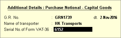

8. Set the option Provide VAT details? to Yes . In the Statutory Details screen
o Enter the purchase details as shown below:
o Press Enter to save and return to the purchase voucher.
The purchase voucher appears as shown below:
9. Press Enter to save.
