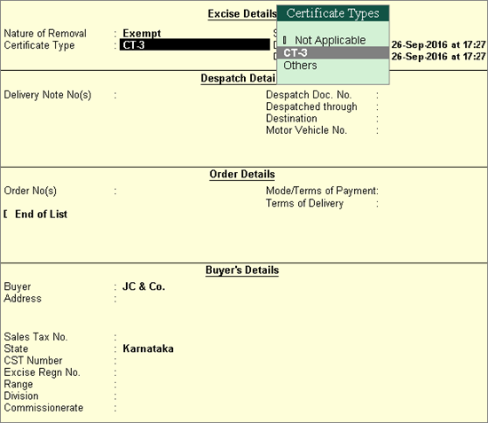

6. In the Party Details screen,
o Select Exempt in Nature of Removal .
o Select CT3 in Certificate Type , and enter the other required details.
o Press Ctrl+A to accept.

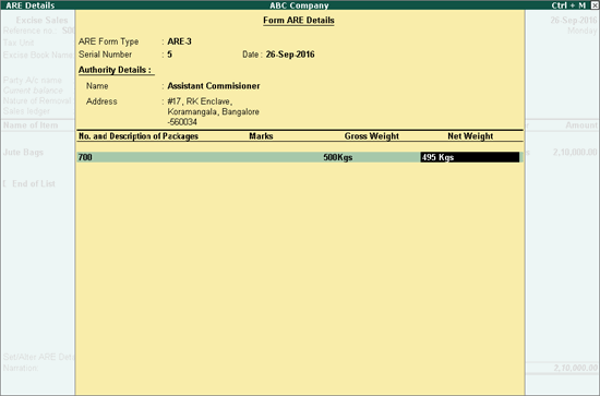

9. Enable Set/Alter ARE Details? . Enter the details as required in the Form ARE Details sub-screen:
10. Press Enter to save and return to Voucher Creation screen.

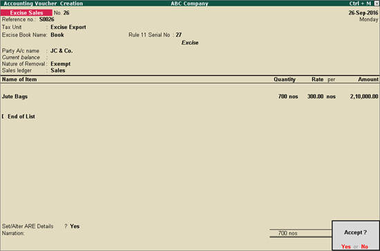

The completed voucher appears as shown below:
11. Press Enter to save.
