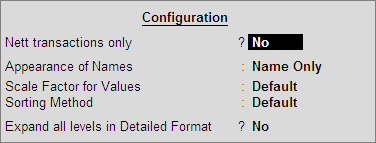

4. Press F12: Configure to set the required options, as shown below:
Note: By default, the options Show Opening Balances and Show Closing Balances are set to Yes in F12:Configuration of Cash/Bank Opening/Closing Summary .

7. Press F12: Configure to set the required options, as shown below:

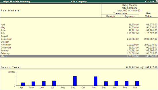

1. Select the required ledger from the Receipts and Payment Summary report. The Ledger Monthly Summary screen of the selected ledger appears as shown below:
This report displays all the monthly summary of receipt and payment transactions of selected ledger.
2. Press F2: Period to change the period as required.
3. Press F4: Ledger to view the summary ledger monthly summary of the required ledger.
4. Press F5: Quarterly/Monthly to view the quarterly/monthly ledger summary of the selected ledger.
5. Press F12: Configure to set the required options, as shown below:

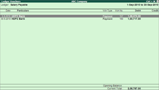

6. Select the required month to view the Ledger Vouchers screen which appears as shown below:
