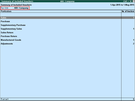

Summary of Included Transactions
This report displays the logical grouping of voucher types used for recording excise transactions which are captured in ER 3. The total voucher count displayed here will be same as the count shown in the Included Transactions row of ER 3 report.
Conditions for a transaction to be classified as Included
● The excise forms are tax unit based. The transactions in which the selected tax unit has been tagged will be displayed in the 'Included' list of transactions.
● The sales or purchase transaction recorded or the CENVAT availment entry should be such that both it affects both the accounting books and the inventory books of the company.
● The duty applicable should be grouped under Excise or CENVAT.
To view the Summary of Included Vouchers screen
● Select Included Transactions , and press Enter .
The Summary of Included Vouchers screen appears as shown below:
The transactions are grouped under the following categories:
Sales
Purchases
Supplementary Sales
Sales Return
Purchase Return
Manufactured Goods
Adjustments
The transactions that are in the included category can be excluded, if required.
To exclude a voucher
1. Select the transaction to be excluded.
2. Press Enter to drill down to the Included Vouchers report.
3. Click X : Exclude Vouchers .
A message Do you want to exclude this voucher? is displayed. Click Yes to exclude the voucher.

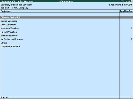

Summary of Excluded Transactions
This report displays all the transactions that are not considered for the generation of Form ER3. The following transactions will be classified as excluded:
● Transactions which do not have excise implications
● Any transaction which does not involve inventory.
● Any transaction that does not affect the accounting books (For example, Order vouchers, Delivery Note, Receipt Note, and so on.)
● Sales transactions with Removal as Such selected as the Nature of Removal .
To view the Summary of Excluded Vouchers screen
● Select Excluded Transactions , and press Enter .
The Summary of Excluded Vouchers screen appears as shown below:
Different Excise Unit
Contra Voucher
Order Vouchers
Inventory Vouchers
Payroll Vouchers
Excluded by Users
No Excise Implication
Others
Cancelled Vouchers
The transactions in the excluded list can be pushed to the included list, if required by drilling down to the voucher and resolving the exception.

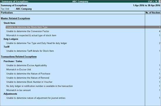

Summary of Exceptions
Transactions with missing or mismatched information in transactions will be displayed under Uncertain Transactions .
To view the Summary of Exceptions screen
● Select Uncertain Transactions and press Enter .
The Summary of Exceptions screen appears as shown below:
Transactions with missing or mismatched information in transactions will be displayed under uncertain transactions.
